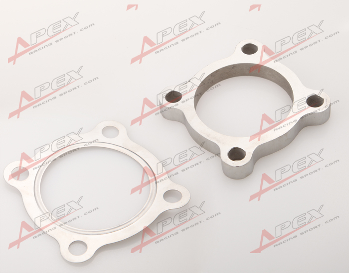

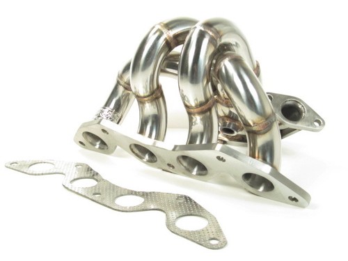

Merhaba arkadaslar bugun sabaha kadar yaptigim arastirmalar sonucunda Aldigim Turbo kiti... Sizlerle paylasmak istedim...
OBX Turbo Manifold 01-05 Honda Civic D17 1.7L EX LX DX SOHC D Series T3  $250
Garrett Turbo T3/T4 60-1 60mm Turbo T60 T04S 550hp .63 A/R  $900
TIAL 35mm 38mm EXTERNAL TURBO WASTEGATE WASTE GATE F38 RED 2 BOLT With PIPE  $250
3" 4 Bolt SS304 Turbo Exhaust Downpipe Flange + Gasket T4 GT35 T3/60-1 GT3582R  $70
TIAL BLUE T2 UNIVERSAL ADJUSTABLE MANUAL GAUGE TURBO BOOST CONTROLLER 1-30 PSI JDM $150
31"X11" BIG BAR PLATE INTERCOOLER + CHROME RS STYLE BLOW OFF VALVE + COUPLERS  $450
